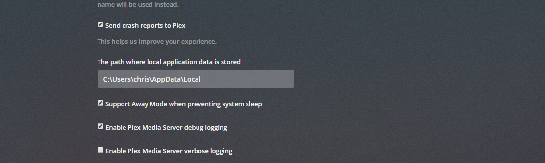

You can go to plex server settings and see the data path.
Yup, I’ve tried using that directory, and the C: root, also on my desktop but all are having the same issue.

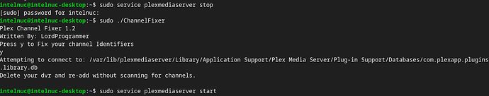

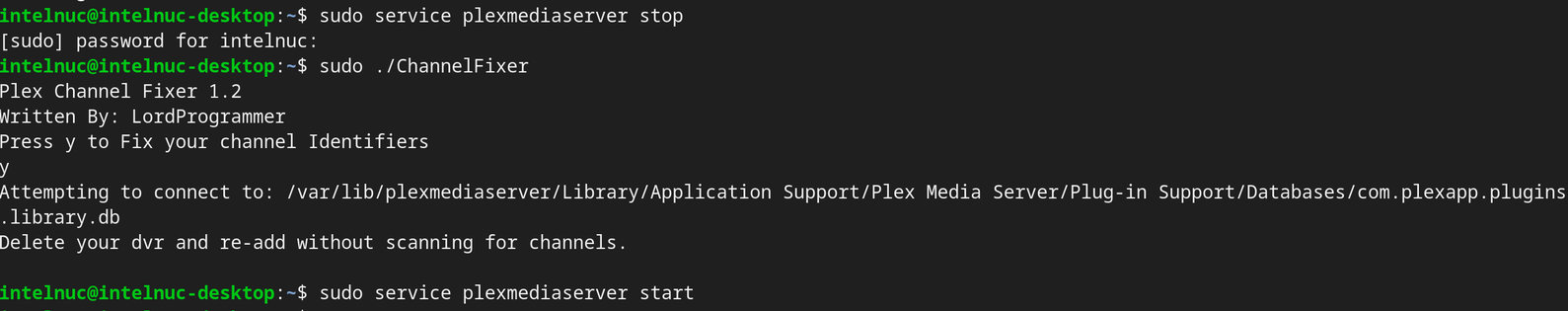

I’ve followed the instructions for Linux (Ubuntu 18.04, Plex 1.18)
I’m not sure it’s doing anything. Am I missing anything?
After re-adding the DVR, the channels are the same.
On the initial scan, there were 440 channels, but this then dropped down to 138 at completion and I’m missing all my HD channels.
I’m using a Hauppage WinTV Dual HD USB stick. It works in TVHeadend.
Are you re-adding the dvr and not scanning the second time?
