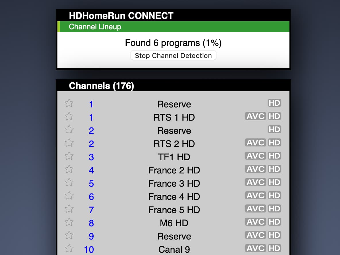

My cable provider, CityCable, changed their DOCSIS channel lineup and on channels 1 and 2 they introduced two streams, the 1st to advise the people to rescan, and the 2nd stream being the real TV (in these case the regional national TV RTS 1 and 2).
Plex only discovers and plays the 1st stream. HDHomeRun from SiliconDust can only see the first stream but can’t play it. On there Channels app from the Apple AppStore, I saw once (maybe during a channel re-scan) both streams on these channels. But now it shows just the reserved ones, ie those displaying the guide to re-scan…
It seems to be that Plex could address the issue while is about MPEG stream decoding and it already can recognize and play the first stream…
Regardless, I opened a question to SiliconDust and I do appreciate any suggestion,
Thanks, Horia
PS: I did a scan test from the streamer web interface, surprise the streams are well visible, see attached

I tried a rescan just now, I still see the reserved channels on 1 and 2, and even stranger, the streamer forces to discard RTS 1 and 2. The red crosses are automatic and if I try to move them to Reserved, the streamer changes back, during the scanning process.

Je vous joints aussi un fichier log scan0 que j’ai obtenu en faisant la commande “C:\Program Files\Silicondust\HDHomeRun>hdhomerun_config 1230DFB0 scan /tuner0 d:\scan0.log” (Il faut au préalable avoir installé l’application spéciale utilitaire de configuration “hdhomerun_windows_20210720.exe”). Dans ce log, vous pouvez constater que tous les canaux y sont répertoriés, RTS 1 HD et RTS 2 HD, mais aussi les Reserve 0.
