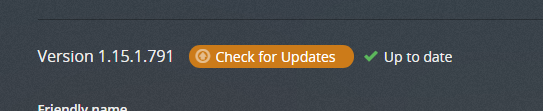

My server is stuck. Is there something specific to server updates that I need to verify isn’t being blocked?

Ok… If updates aren’t showing up for that build, you might try manually updating from the Plex site:
https://www.plex.tv/media-server-downloads/
I also saw that they said automatic updates will be down for a few days, so it could be related to that.
"Plex Media Server 1.15.1.791 is now available to everyone
Note: Auto-update will be disabled for a few days. In the meantime, you can grab the new version from our Downloads page ."
Thanks for posting that. I was having the same problem as the image shows. That makes sense.

I this still an issue - is auto-update server still suspended? I have the same exact problem as first post. (my screenshot would look identical, version and all)

UPDATE: I just tried upgrading plex using ‘yum localinstall’ with the i686 RPM before going complicated.
Update went flawlessly.
Now checking for updates works just fine and I have the latest version installed and working.
