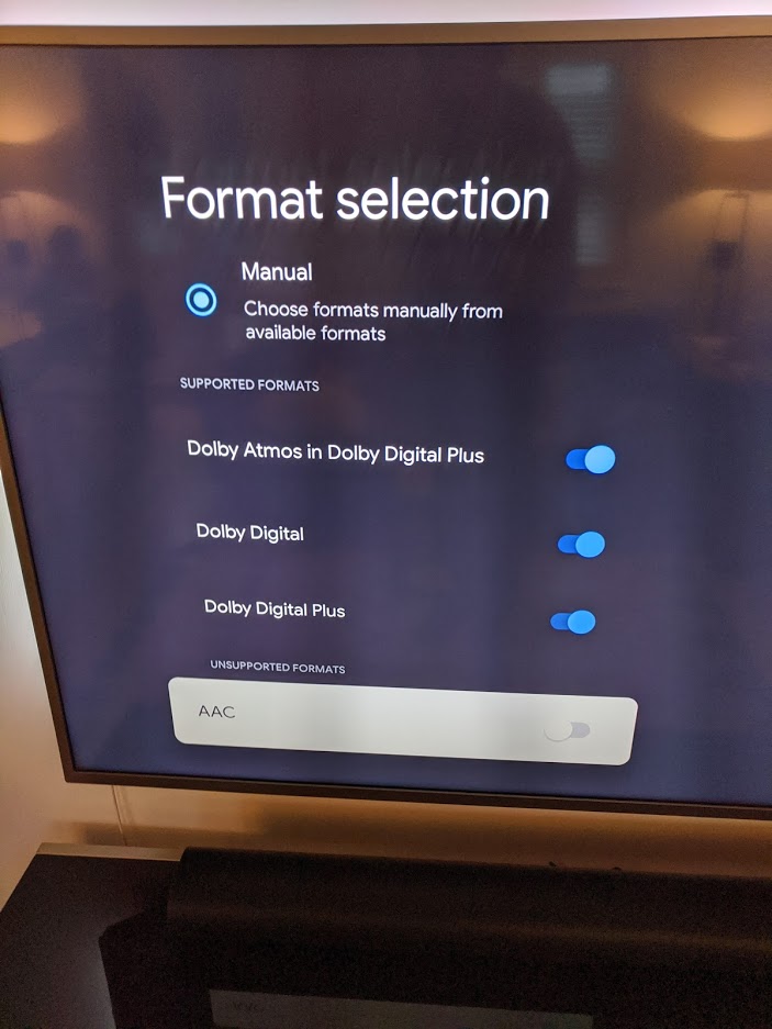

Sound settings on the Chromecast wGTV (such a stupid name) are set to automatic and all options are showing as supported except for AAC! If I choose Manual instead of Automatic it will let me select AAC but then gives a warning that it might not working and if I play something it stutters and plays at about 2fps and not in DD5.1.
Try this. In the Plex app, enabled passthrough. Change it from HDMI to Optical, you will then be able to select codecs. Enable AC3 and turn everything else off. Try playing your video now.
Is the point of changing from HDMI to Optical to disable capability detection, so that you get to choose things manually?
Yes. Although this is a bug. The settings for optical shouldn’t affect hdmi passthrough, but it does, at least for now. So you can disable codecs that are reported incorrectly.
