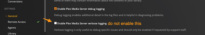

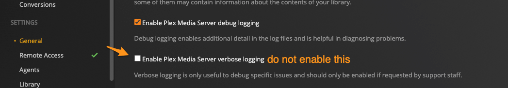

@hysel can you please disable “verbose” logging save the setting then restart your server and try again. (only “debug” logging should be enabled)
There you go
Plex Media Server Logs_2022-07-28_22-46-42.zip (966.6 KB)
