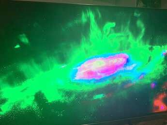

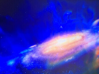

On some/most DolbyVision clips Plex displays “wrong” colours. Using the Tv’s Plex App the colours look right. Using TV+ on aTV shows correct colours as well, it is just the plex atv client.
This clip here: https://www.demolandia.net/downloads.html?id=43567783 for example does not work properly on aTV 4k but works on the Sony Plex Client.
Here is how it looks on apple tv:
And here is the same scene on the Sonyplexapp:
With the Infuse client on the same aTV Dolby Vision works with proper colours. Seems to be the aTV Plex Client.
