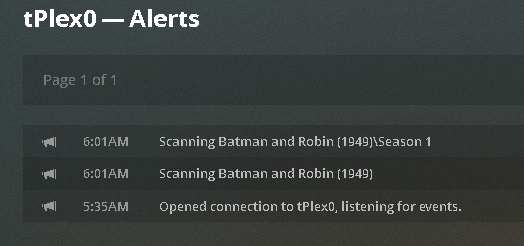

I have this working on Windows 7 in a script for both movies and TV shows…
My setup maybe different not sure…
edit; sorry I was in a rush…
I have it set up on the PMS server so I can right click the folder for a movie or TV show and select Run Plex Scanner.
Selection of a movie…
Selection of a TV series
Both of these folders reside on a NAS…
and if you watch the Alerts on the server…
I use it if I make a change to a Movie or Show that way I get to see the results.

Open a Web Client alert window for monitoring the process, and using the Windows Explorer on the PMS system select a movie folder from your movie library directory/folder and right click and click Run Plex Scanner, a CMD window should open and the process should start. It may take a few minutes. its completed the process when press any key message appears. it’s done and Plex should be doing it’s job on the selected directory/folder.
If anyone would like to add, streamline the process etc… feel free…
I hacked this together to fill a need that plex was lacking…
it’s great when that episode your waiting for is finally available, right click the show and get it added to Plex…
