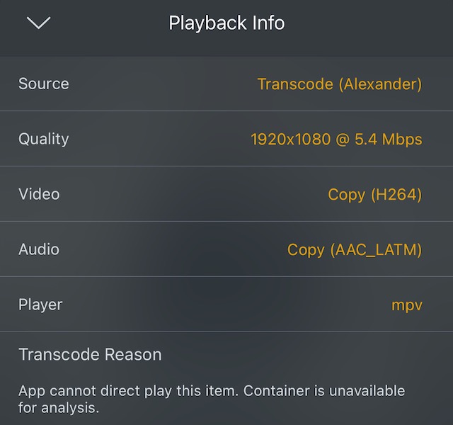

Recorded this today: /Inside Culture with Mary Beard (2020)/Season 02/Inside Culture with Mary Beard (2020) - S02E06 - Inside Culture with Mary Beard.ts
XML: 9192.xml - Google Drive
And get the error:

I’m not really clear on what you are saying. Are you saying that Skip Ads is different than Skip Intro? I use the setting ā€œDetect Commercials and Mark for Skipā€ when I record shows. Skip Ads doesn’t work properly if I haven’t manually analyzed the show prior to watching it. I rarely see Skip Intro because most shows that are recorded from an antenna start right into the show.
If I don’t run ā€œAnalyzeā€ on the show before watching it, the show doesn’t Direct Play because Plex can’t figure out the container. And then when I hit the button to Skip Ads, the playback is frozen for the length of time it takes for the commercials to actually play. I can also exit out of the show and resume it instead of waiting for the commercial play time. When it resumes, the show resumes at the end of the commercials.
If I run ā€œanalyzeā€ on the show before watching it, the show Direct Plays and Skip Ads works properly. Clearly the Skip Ads problem is related to the fact that the show is not Direct Playing and/or the fact that the type of container is missing.
