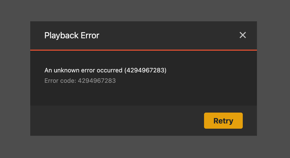

Since about 48 hours ago, no videos added to Plex are being properly analyzed as they all show “None” for Video and Audio and will not play.
MacOS Player error
Playback Error
An unknown error occurred (4294967283)
Error code: 4294967283
The manual Alalyze funtion for a video just spins indefinitely without doing anything.
Should note that all the files in question playback fine in MacOS in the QuickTime player and other players.
