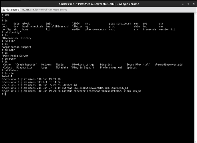

This is my appdata (container) directory where PMS is stored.
root@Gerbil:/mnt/user/appdata/Plex-Media-Server/Library/Application Support/Plex Media Server/Codecs# ls  -la
total 1004
drwxr-xr-x 1 nobody users     205 Nov 10 18:51 ./
drwxr-xr-x 1 nobody users     276 Nov 10 19:05 ../
-rw-r--r-- 1 nobody users      36 Jun  5 17:23 .device-id
drwxr-xr-x 1 nobody users     244 Jun 27 08:49 46f74ab-560174306fe167a5978a79dd-linux-x86_64/
drwxr-xr-x 1 nobody users      30 Jun 19 18:28 EasyAudioEncoder-8f4ca5ead7783c54a4930420-linux-x86_64/
-rw-r--r-- 1 nobody users 1020638 Nov 10 18:51 EasyAudioEncoder-8f4ca5ead7783c54a4930420-linux-x86_64.zip
root@Gerbil:/mnt/user/appdata/Plex-Media-Server/Library/Application Support/Plex Media Server/Codecs# cd 46f74ab-560174306fe167a5978a79dd-linux-x86_64/
root@Gerbil:/mnt/user/appdata/Plex-Media-Server/Library/Application Support/Plex Media Server/Codecs/46f74ab-560174306fe167a5978a79dd-linux-x86_64# ls -la
total 6196
drwxr-xr-x 1 nobody users     244 Jun 27 08:49 ./
drwxr-xr-x 1 nobody users     205 Nov 10 18:51 ../
-rw-r--r-- 1 nobody users  203928 Jun 10 07:30 libaac_encoder.so
-rw-r--r-- 1 nobody users  300584 Jun  5 18:40 libdca_decoder.so
-rw-r--r-- 1 nobody users 1596496 Jun  5 17:30 libh264_decoder.so
-rw-r--r-- 1 nobody users 1509968 Jun  5 17:30 libhevc_decoder.so
-rw-r--r-- 1 nobody users  124968 Jun 27 08:24 libmp3_decoder.so
-rw-r--r-- 1 nobody users  553200 Jun  5 17:34 libmpeg2video_decoder.so
-rw-r--r-- 1 nobody users  772656 Jun  5 17:38 libmpeg4_decoder.so
-rw-r--r-- 1 nobody users 1132448 Jun  5 17:37 libvc1_decoder.so
-rw-r--r-- 1 nobody users  135120 Jun 27 08:49 libwmav2_decoder.so
You should have the same/similar
