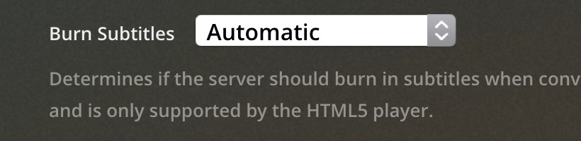

In the web app (chrome) what do you have set here (Settings -> Player):

burn subtitles is indeed set to automatic, direct play and direct stream are also checked
ok thanks, like I said it should have an impact in this case but worth checking:

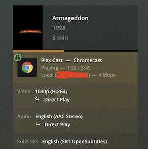

Thanks, I’m not using the Ultra but I am on FreeBSD and same PMS version:
This seems to wok fine casting from Chrome to the built-in Shield Chromecast.
