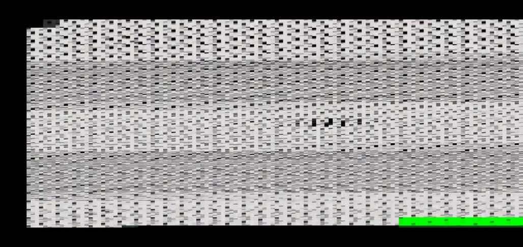

Corrupted video output stream with hardware transcoding
Server Version#: 1.18.2.2058 (QNAP NAS)
Player Version#: 7.25.1.14216 (Android Mobile)
Since version 1.18.1.1973 hardware transcondig fails regardless of the client device (Android TV, Android Phone, Chromcast Ultra, Windows 10) used.
As a workarround I can disable the hardware transcondig on the PLEX Media Server. But this results in a very high CPU load on my QNAP 453Be NAS (Intel J3455 HD Graphics 500)
Changing the transcoder settings doen’t make any diffrence. So for the moment I have downgraded PLEX Media Server from version 1.18.2.2058 to version 1.18.0.1944.
