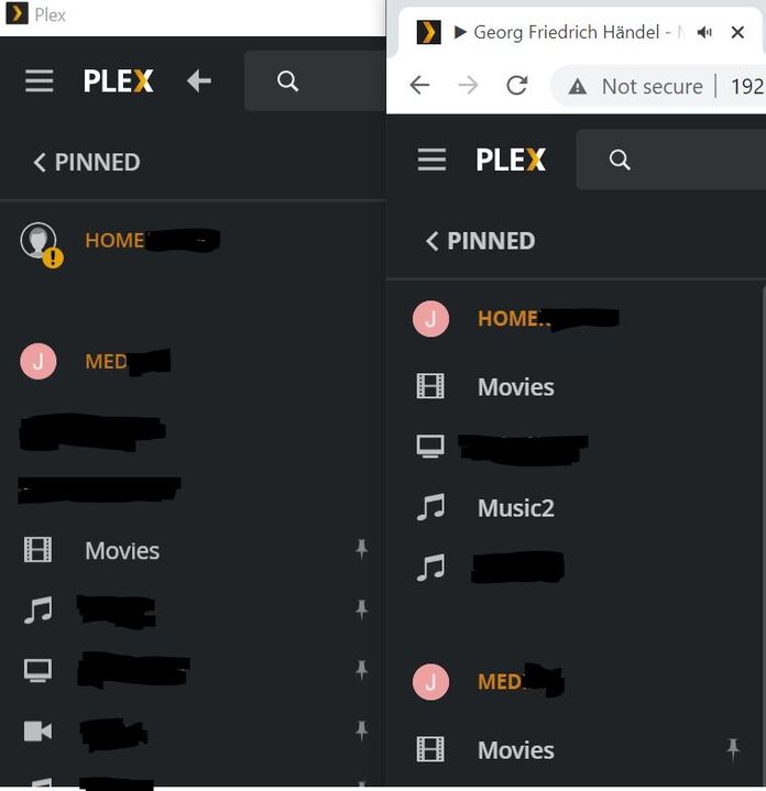

Hi Guys,
I have two subnet, 192.168.100.0/24 and 192.168.1.0/24. I put one of my server in 192.168.1.0/24, and I want to access it from 192.168.100.0/24. I set the “List of IP addresses and networks that are allowed without auth” as 192.168.0.0/255.255.0.0. And it does make me can access it from explorer(chrome). However, I cannot do the same if I use the Plex App. The server could not be connected from app.
Any idea?

Adding the same information for the subnet to “lan network” works. Thanks guys.
