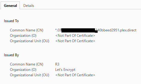

Team, I’m unable to resolve an issue with using my custom domain certificate. Instead, it is using a *.plex.direct certificate.
After reviewing the community forums, I found a suggestion to disable remote access. I did have remote access enabled, and this could explain why my custom domain wasn’t getting used. However, after disabling remote access I’m still seeing the *.plex.direct certificate.
Any suggestions on resolving this will be greatly appreciated. I already verified a proper .pkcs12 file, password, custom domain, and custom URL configurations are correct.

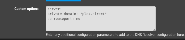

Lastly, For the DNS resolver, can you make an entry (pretty sure you can) which allows the private domain overlay on the LAN … aka DNS Rebinding.
Looks like this on PfSense

I am suggesting creating a DNS Resolver entry in your DNS server/resolver module of Palo Alto to allow the FQDN hostnames in the plex.direct domain to resolve to LAN addresses (This is what DNS rebinding protection is designed for). We’ve seen many firewalls / routers which were so super-strict that Plex would not run without allowing ‘plex.direct’ on LAN to resolve.
I understand. “If you’re looking for plex.direct, go to plex.localdomain”. Let me get this configured and test.
EDIT: Actually, I don’t think DNS is the issue here. I’m not browsing to plex.direct. I get to the server using the correct DNS. Resolving works just fine, but the server certificate presented for secure connections remains plex.direct as opposed to the configured certificate.
NOTE: Ping timeout due to firewall block policy. The server is reachable.
Do you think the server configurations are somehow stuck using the plex.direct certificate after having remote streaming enabled? I’m not against completely starting over. It doesn’t take too long to rebuild the library.
