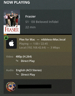

Dashboard "Now Playing" missing info on 480p streams
Server Version#: 1.17.0.1709
Player Version#: local version : 3.108.2
Player Version#: remote version: 4.8.1
Probably reported elsewhere, but I couldn’t find it.
Whenever a video is 480p (DVD rip) the dashboard does not show any of the information regarding the stream - direct play, codec, etc. All other resolutions seem to work properly. I would guess it’s a server issue, rather than the web app, because Tautilli shows the same non-existent / missing info.
Web_app
I’ve attached the XML from the 480p file that is in the images, and server logs, if that will help.
BatmanBeginsXML.txt (28.2 KB) Plex Media Server Logs_2019-09-30_20-20-09.zip (4.8 MB)
Oops! My mistake. The “Batman Begins” video seems to be streaming at 720p. I have two versions, of it, one at 720p and one at 480p. Perhaps it’s the 2 versions causing the problem. It used to work right, and checking the “now playing” screen is not something I do regularly, so I can’t say when it started to fail.

The files in the screenshot above direct play correctly with no glitches, are not transcoded, and are simply not reported correctly in the Dashboard. I’ve provided the XML for the files and a server log.
I can also add, that if the file is played on a Roku, or with the Web app, the information on the dashboard displays properly. If the file is played on Android TV, the normal streaming info is missing. In all cases, the file is direct played. Perhaps I’ll edit the tags for this post so the android devs will see it as well
I reported it because it is a glitch, not the end of the world. But you’re right, it is just visual.
And this glitch is being carried over to Tautulli as well.
It’s odd because the XML reports the correct info.
<Stream id="2784734" streamType="1" codec="h264" index="0" bitrate="450000" height="480" width="640" displayTitle="480p (H.264)" />
<Stream id="2784735" streamType="2" selected="1" codec="aac" index="1" channels="2" language="English" languageCode="eng" displayTitle="English (AAC Stereo)" />
