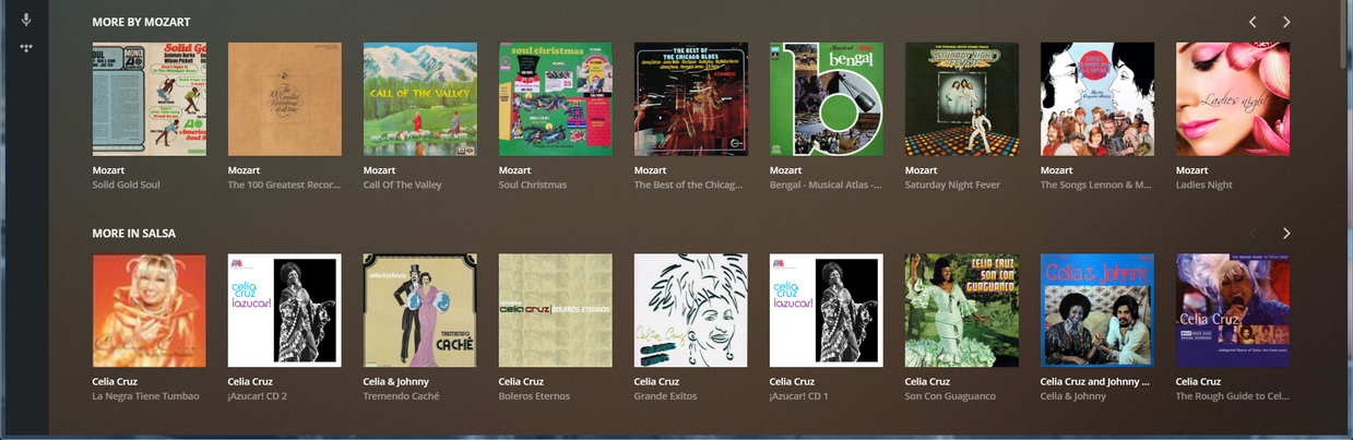

I used the Masstagger plugin for Foobar 2000 to overhaul the meta tags across the whole library. Now there is nothing without an Album Artist, and nothing without an Album name designated. I made dummy album names like (Compilation), (Album), (Miscellany) and such like to bundle old single MP3 files laying around. Today I did a library wide ‘Refresh All Metadata’. It correctly refreshed some albums that I noticed.
It also did what the following screenshots show. I only took a cursory look. I don’t know how many albums have been assigned to Mozart. It looks like the whole 100 albums of the Franklin Mint Collection has been given to Mozart. And, look at the photo it has brought from the cloud for Mozart. None of these are Unknown or Various Artists. They are all properly tagged albums sitting in dedicated directories, with the artist and album in the directory path.
Of course, I have included the second row to show how it works when it works properly. I shared the screenshots because I did not want anyone to think I’m exaggerating or trolling. Plex Music is alpha software at best. Movies and TV shows work fine for me. It did not recognize some Shakespeare videos, but that’s okay.
