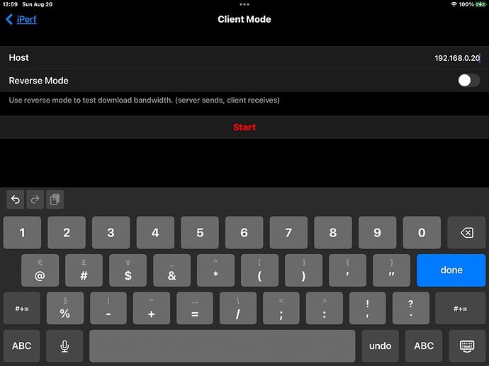

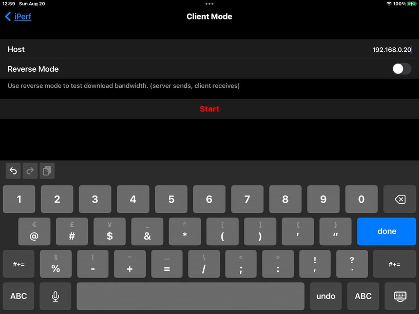

Testing -
  1. Launch server (‘iperf3 -s’)

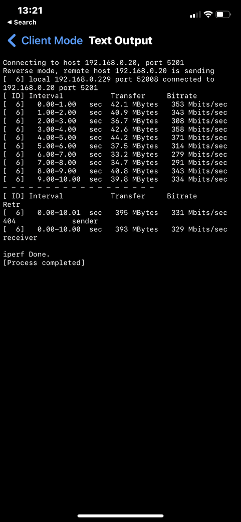

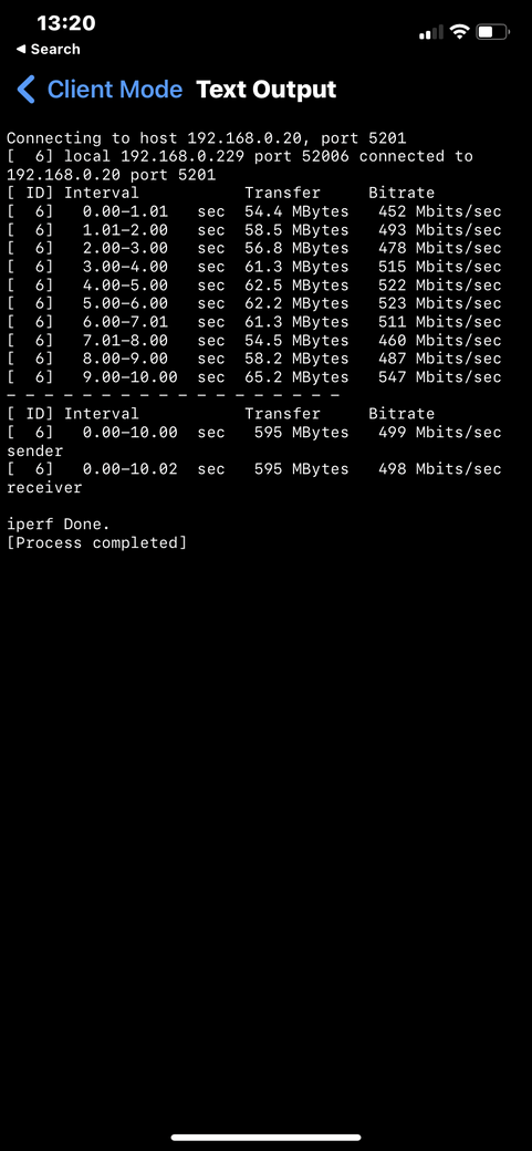

  2. from each client, test Forward and Reverse directions (upload/download)
(Ipad Pro 2019)
Lastly “Reverse”
From this, we see:
  • 2019 iPad Pro can transmit about 500 Mbps and receive about 350-ish Mbps

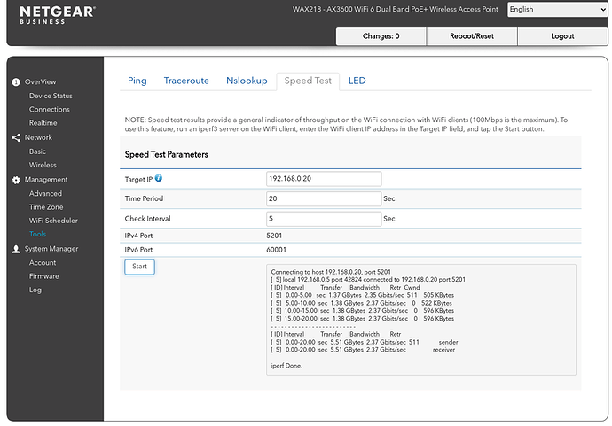

One last test – The AP itself
  1. Test AP → PMS server
  2. Test AP → Player (the iPad in this case)
