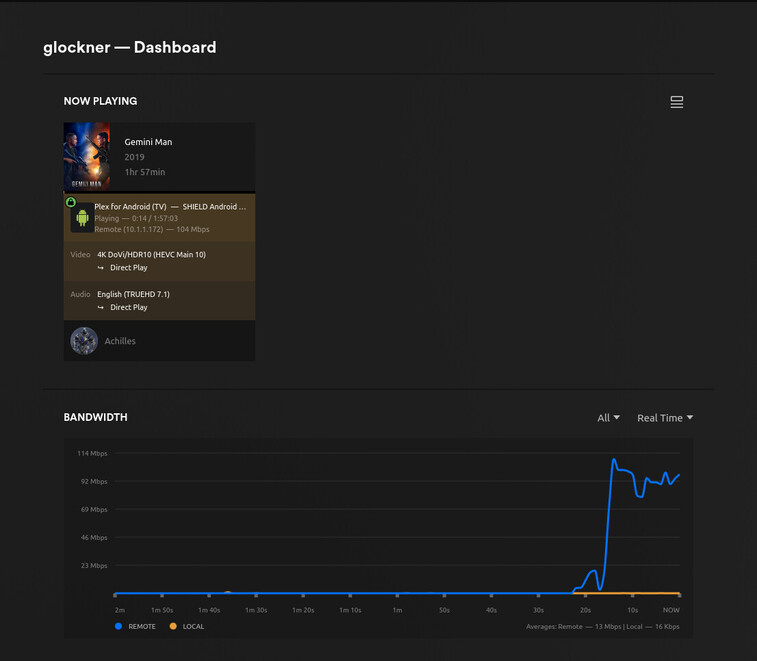

This is what we’re looking at (my friend in California and I are on the phone)
Here we are, right now, UDP VPN tunnel, between us.
EDIT: Reaching steady state
Sorry I don’t know what this means. But my plex dash shows the same as this when i’m having issues. It will show the full bandwidth being used, never really dropping, but the playback will still buffer
Okay yes but the dashboard graph would look the same on my end. It doesn’t seem to be an issue of the bandwidth cutting out
