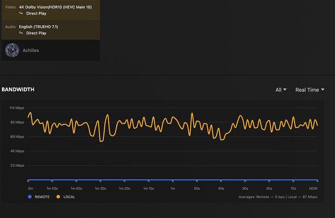

Ping from my MacBook via WiFi to LAN IP of PMS:
30/30 packets received (100.0%) 202.862 min / 205.683 avg / 215.807 max
Server Host: Ubuntu 22.04.3 LTS Desktop
Server Version: 1.25.9.5721-965587f64
Client Version: Plex for Mac 1.79.1.3984-879339ed
Not experiencing any Direct Play issues with 200ms of simulated latency.
Media
  • Duration 1:57:03
  • Bitrate 89879 kbps
  • Width 3840
  • Height 2160
  • Aspect Ratio 1.78
  • Video Resolution 4K
  • Container MKV
  • Video Frame Rate 60p
  • Video Profile main 10

No…RaptorTurkey used Plex for Windows. I am using Plex for Mac to conduct this test.
From my testing, the client doesn’t matter as it’s a fallacy in the server calculation. But in order to sate a real world scenario I’ll have a friend from the US conduct two tests, running iperf3 both ends. One without the MPV config options, and one with the buffer config options.

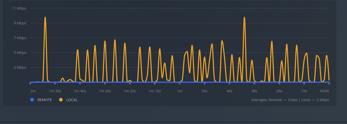

A quick test right here, you can even visibly see bizarre network behaviour. Client buffers playback of a 59.4 Mbps bitrate file over LAN with 75ms up/down latency on ALL traffic negotiated between client and server (lag)
Or here was from a more reasonable test. There’s clear breaks/pauses in activity as the plex server waits for the client response before sending more data.

In the below image you can even see snaps of a lot of variance over even LAN because of the notably aging delivery method, there’s just better alternatives.

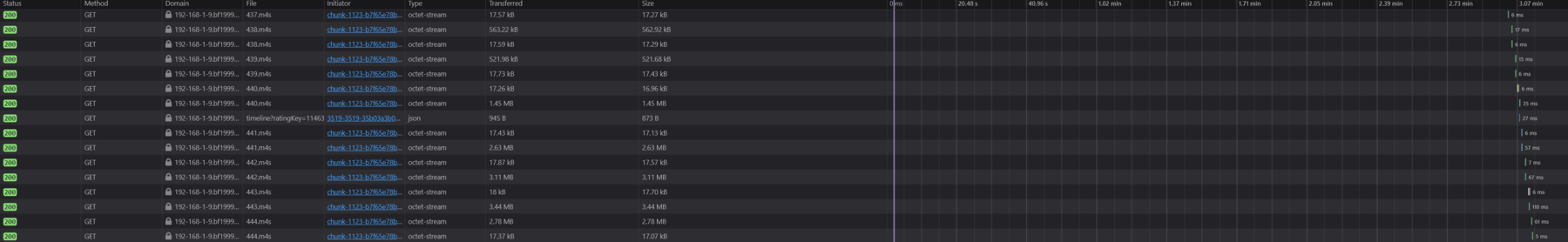

Image 1: plex windows client connecting to plex windows server, direct play of a 4k video. MPV conf unedited.
Image 2: same test as above, MPV conf edited

  1. PMS v1.25.9 on Ubuntu 22.04.3 Desktop host
  2. Media with over 8Mbps
  3. Plex for Mac 1.79 installed on macOS 14.0 Sonoma
  4. Network Link Conditioner installed to add 200ms of latency
  5. Direct Play playback of title with 87Mbps without buffering
Please do pray tell the context that was missing from my post that you are looking for?

The stated conditions were satisfied.
  1. “Install PMS on choice host machine” – PMS 1.25.9 on Ubunutu 22.04.3
  2. “Media over 8 Mbps” – Test media is 87 Mbps
  3. “Install Plex client on any applicable system” - MacOS player 1.79 used
  4. “Set simulated latency to exceed 150ms” – Link conditioner set to 200 ms.
  5. “Attempt directplay playback of the 8+ Mbps bitrate file” – 87 Mbps file DirectPlay.
Achilles satisfied the conditions as set forth.
Whining and attempting to deflect, after the test results, which satisfy the required test environment, do no support the assertion, – Poor Form / Too Bad.
