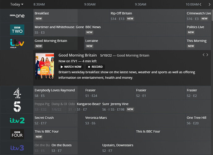

For terrestrial tv, I have an aerial in my loft which is plugged into a raspberry pi with a tv hat and a couple of usb xbox DVB-T tuners. This is running tvheadendand and tvhproxy so plex see’s it as a HDHomerun Connect.
I only set that up as a proof of concept before spending money on the setup but it has been working fine for me so haven’t bothered paying for a HDHomerun.
If you want to go down this route without the setup hassle then get a HDHomerun Connect Duo or Quatro (depending on how many channels you want to watch/record at once)

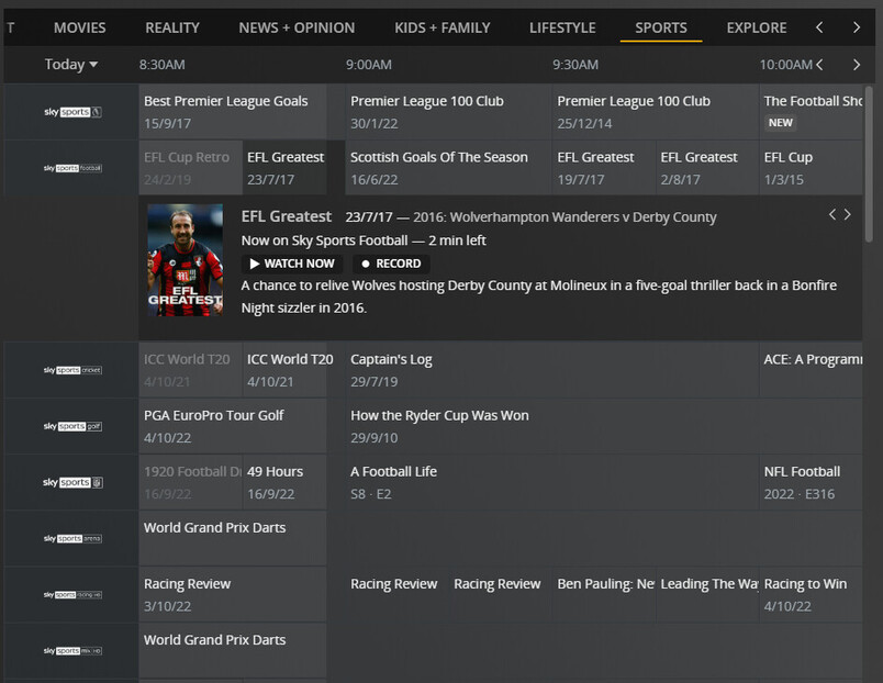

I also have an IPTV subscription for my Sky channels. They provide an m3u file which I pass through Xteve which again appears to plex as a HDHomerun. It takes a fair amount of time to setup but is worth it. I also have the added bonus of some overseas channels that show the 3pm football games.
The TV guide is nice and easy to use for anyone in the family. Apart from a few teething issues with recordings, it all works pretty well and are happy with the switch.

i assume you dont use built in guide data as you are mixing multiple sources
how do you build your xmltv file ?
This is the Plex provided EPG. Multiple Tuners is fine for Plex EPG but you can’t mix Plex and xmltv guide sources (unsure why)
Problem is that Plex guide data doesn’t support all regions, so as a workaround I have another instance of Plex running on my NAS for unsupported regions with xmltv guide. This solution isn’t ideal though as the NAS doesn’t have much transcoding power.
I am trying to match the quality of the Plex EPG with xmltv files so I can can bring it all under one roof but have hit a pain point there and not heard anything back on my post here

Yeah I set up a new library for TV recordings but you can just record to existing libraries
