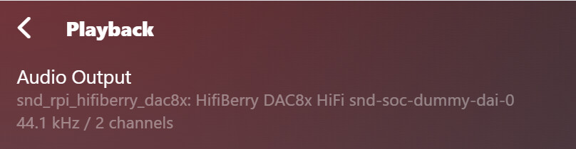

However, please review this screenshot:
It says 44.1 kHz 2 channel.
Any other configurations I’m playing with to try and get plexamp to output 5.1 audio to my OS configurations that will then downmix it to 4.0, I also see this.
Now that I see it always displays this even when it isn’t true, that means this bit of info is meaningless. It isn’t always true.
I don’t understand how this is meant to work - is it meant to show inaccurate data?

It is not showing “live data”, it doesn’t have visibility of what’s going on all the way down the audio stack.
Make sure you have Sample Rate Matching enabled for any non-stereo sort of configurations.
