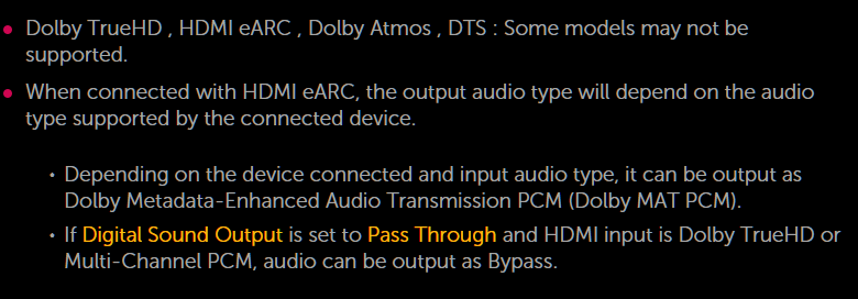

Also - the documentation makes in clear:
  1. Dolby AC-4, MPEG-H 3D Audio, DTS, DTS-HD, and DTS:X are available in specific models only.
So I guess in my case the 2024 LG C4 model is one of those specific models.

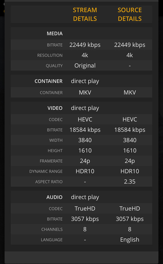

I started playing a 4K HDR (HEVC Main 10) with TRUEHD with the WebOS Plex client.
The Plex web app showing activity shows:
So you would think all is good?
Not so.
The receiver connected over eARC displays DD+ only not TRUEHD.
In some TRUEHD content the receiver just displays stereo.
In the WebOS version of Plex - displaying the INFO overlay you can see the issue:
Decision:
Reasons:
Cannot direct play with protocol: https, codec:truehd. Not found in profile
Cannot direct stream with protocol: hls, codec:truehd. Not found in profile.
This aligns with the WebOS developer pages.
Now - this content has TRUEHD, AC3, DTSHD-MA
Passes this audio DTSHD-MA confirmed at the receiver.
Investigated more…
In the TV settings - Digital Sound Output - Help:
Settings/Settings/Sound/Advanced Settings/Digital Sound Output.
In the Dolby TrueHD section it has in brackets (HDMI only)
For DTS-HD, and DTS:X there is no similar mention of (HDMI only)
See LG OLED EVO online manual under sound/digital sound output
The caveat - Some models may not be supported. Which models?
I’d be fine with multichannel PCM if I knew the lossless codec was being converted into multi-channel PCM.
This aligns with my experience.
All the audio codecs - TrueHD, DTS-HD MA pass fine over eARC from HDMI sources, just not with any internal WebOS application.
