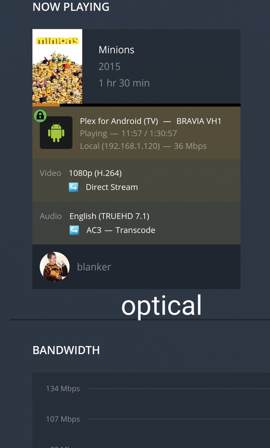

Hi, I didn’t get a chance to test your recommendations yet, but… I switched my passthrough setting on tv plex app from hdmi to optical and selected both checkboxes (ac3 and dts) on next tile, and now the problem video (true hd) plays in dd 5.1. the playback info still said “transcoding” for the video (not sure why), but, what do you think? Problem solved? Do i just leave it in optical from now on?

With passthrough = optical, the Plex app behaves as if it has an optical, not HDMI, connection to the TV.
It fixes the problem for TrueHD, forcing a transcode to AC3 5.1. However, Dolby Digital Plus, including Dolby Digital Plus + Atmos, will also transcode (and Atmos info lost).
Optical audio is limited to AC3 & dts at 5.1 or fewer channels and PCM at 2.0 or 1.0. Dolby Digital Plus (EAC3), TrueHD, and dts-HD is not supported by the optical audio standard.
So, with passthrough = optical:
  • AC3 and dts should direct play and passthrough to the receiver.
  • TrueHD and Dolby Digital Plus will transcode.
  • dts-HD MA will most likely direct play, but pass only the lossy dts 5.1 core.
  • I’m not sure what will happen with AAC audio. AAC 2.0 will probably direct play and pass to the receiver as PCM 2.0. No idea with AAC 5.1 audio. It could be downmixed to PCM 2.0 or transcoded to AC3 5.1. You’ll just have to try it to find out (I can’t replicate your setup or I would test it myself).
As long as you are OK with Dolby Digital Plus transcoding and whatever happens with AAC, then it is not a problem running with passthrough = optical.
I can’t decode atmos, 5.1 is fine for me, and Nothing I play has dd+. Seems like the silver bullet approach. One of these days I’ll get a shield, but one remote/no set top boxes/simplicity is paramount for me now.

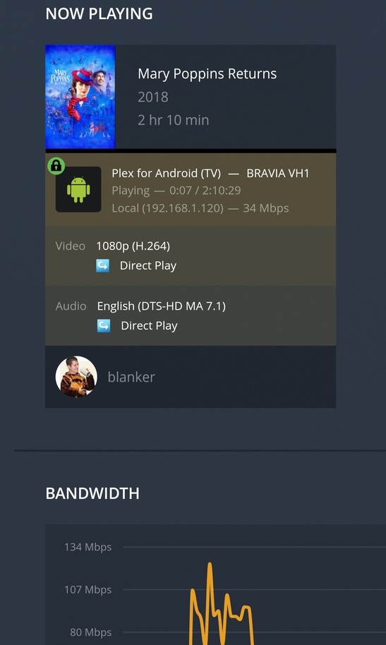

Okay looked into it. Monitored playing a bunch of different audio files. It basically has a problem with playing PCM and Dolby true HD. It transcodes the audio to opus. That’s all it says in Plex, however my receiver is outputting it in stereo. Screenshots attached. Other formats are playing fine which is interesting because a couple months ago I couldn’t play DTS master audio without it bugging out.
Ac3 5.1 - direct play
7.1 dts ma - direct play
7.1 pcm- opus stereo
7.1 true hd - opus stereo
5.1 dts ma - direct play
That is with passthrough = HDMI, correct?
I believe this will be fixed in the Plex Android TV 8.29 release, currently in beta.
The topic is discussed in this thread.
If I’m reading the comments correctly, TrueHD will be transcoded to AC3 5.1 or EAC3 5.1 instead of Opus. PCM 7.1 will be transcoded, but should also end up as 5.1 not stereo (I’m not sure to which format it will be converted. I may have missed it in the thread).
