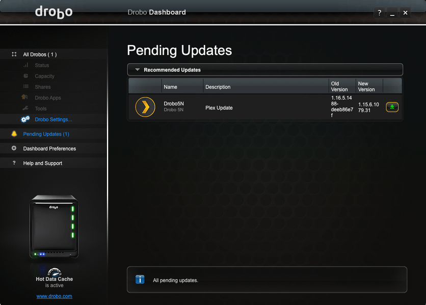

The Drobo dashboard constantly throws its red popup message that I have an app (Plex) that needs updating. I know how to update it manually - and it is currently up to date with the most current version but the dashboard doesn’t seem to know it. I assume that its tied into the fact that you can’t update it directly through the dashboard. Is there something that can me manually edited to stop the incorrect notification?

Hi, this appears to be an issue with the way the DroboApps part of the Drobo checks for updates. If the installed version is newer than the version on their DroboApps “store” then it reports an update is available because the local and store version numbers don’t match.
I’ll see if there is something we can do differently, but I have also seen this with other apps that have been updated to a version greater than the DroboApps store version.

Even worse, my Drobo 5N2 just tried to downgrade its version of Plex from Ver 1.13.9.5456 to version 1.13.2.5156 (7+ upgrades behind the version actually installed). Worse, this patch was in a new section of Drobo Dashboard specifically for upgrades. Drobo, if you’re going to insist on an automated upgrading process, please ensure that your upgrade process actually installs upgrades, not downgrades! I’ve had to re-install Plex as a result of this botched process.

According to Drobo, the newest releases aren’t supported. Only the versions that have been tested.
Their reply to me:
“Thank you for contacting Drobo Technical Support.
We do not support the newest version of Plex so Drobo Dashboard only knows of the version we have tested and have released which ending in .51. It will continue to prompt for that version.”
Hosting media for and running PLEX server is supported, but they don’t rush over to test every release.
I believe a feature that Drobo owners who host a PLEX server could request from Drobo, would be an option to ignore a version mismatch. The difference between version numbers (older or newer) is what trips the Dashboard notification feature. As of the current Dashboard version 3.3.0, the only way to keep an update notification from popping into your desktop is to completely quit the Dashboard.

I have been digging back into the recently and am not sure how it is deciding that it’s own version is more up-to-date. locally on the Drobo there is a script called /usr/bin/semver.sh which takes two versions and returns 1 if the first string is greater than the second, and -1 if it is less than.
This script is part of the DroboApps.sh command line tool which fails to allow me to install the version offered by the Drobo Appls store due to it being less than the installed version
Drobo-5N:/ # DroboApps.sh install_version plex 1.15.6.1079.31
Skipping plex install; local version 1.18.6.2368 is greater or equal to requested version 1.15.6.1079.31.
