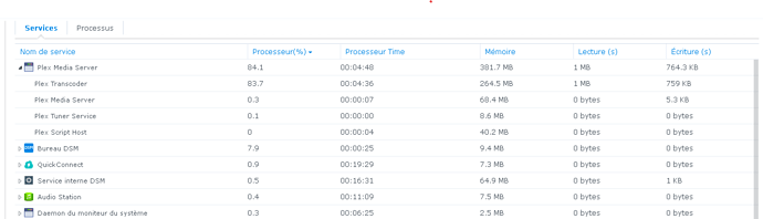

I’m facing a problem : plex server take 98% of my nas’ CPU suddently.
So the video is loading every 10-15 minutes, or plex tell me I have no enought CPU to convert this item.
It’s very annoying and I can’t figure out why it’s making this without apparent reason.
Before this, I had no problem with plex and I thought I didn’t make any modification that can trigger this issue.
I’m connected in local network so I don’t think the problem is related to my network settings.

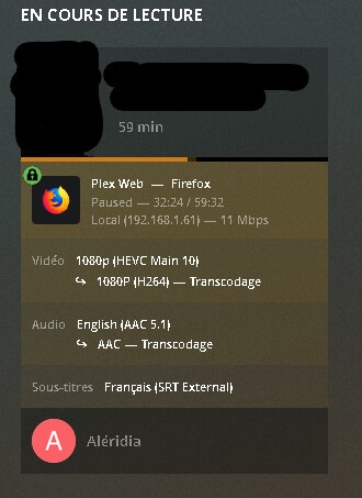

When I’m trying to watch an episode :
The processus and services in the nas :

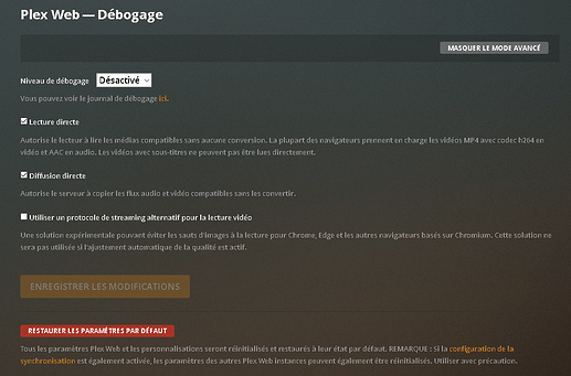

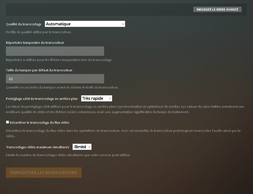

My plex settings :
I’ve tried to test different configurations (Without direct stream, disable video transcoding) and it doesn’t solve my problem.

The video is HEVC. Other than Safari, web browsers do not support HEVC video, so Plex must transcode the video.
You do not have a Plex Pass, so all transcoding is performed by the CPU. The Celeron CPU will struggle with 1080p material, especially HEVC, as it requires more resources to transcode than H.264.
You also have subtitles enabled. This puts an additional load on the CPU, as it has to burn them into the video stream. Note that this process always occurs on the CPU, even if hardware acceleration is enabled.

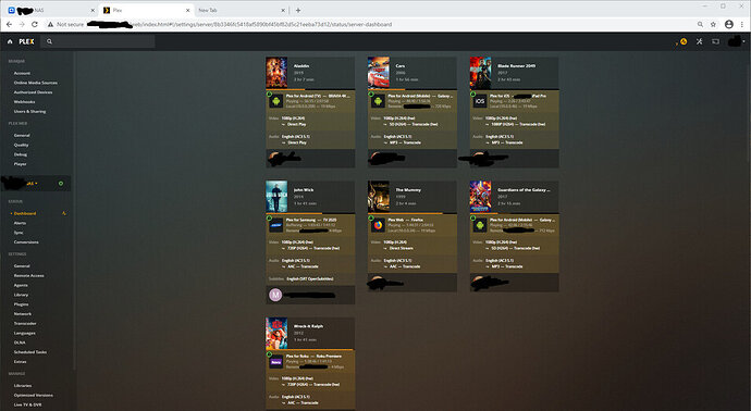

It can burn at least 1 subtitle (srt) if you are using hardware encoding for the video. My TS-453Be (also a J3455) with Plex Pass has done 7 streams one doing subtitles, 4 video trans-coding and several more audio trans-coding, running at 85-ish percent. But yes subtitles puts a hurt on the CPU. Without the subtitles I have seen it run 12 streams and still only be at 70-ish percent with various (I think 6) video encodings.
In my opinion the lifetime Plex Pass is worth it for HW transcoding if one plans on using Plex and supporting servers for any serious length of time.
See below (notice I also have A LOT of different devices using it - Sony TV, Samsung TV, IPAD, Plex Web, 2 Samsung android phones one an S8+ the other an S9 and a Roku). This was all on 2/26/21 Plex FW 1.21.2.3943, QNAP FW 4.5.1.1495 :
