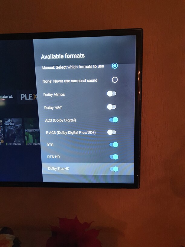

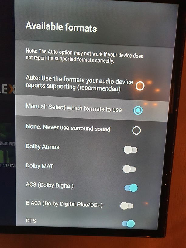

At my end things seems to be working again. I had received a new Nvidia Experience update version 8.2.1 I thought it was installed automaticly but there was this update waiting apparantly. Its an update from november 17. I have installed it and I was hopeful because in the description it said:
  • Fixes bug where audio would randomly drop, requiring a reboot to recover
  • Resolves issue where manually enabling AC3 in “Available formats” was not working as advertised
  • Fixes NETFLIX issue where 5.1 audio would not be available after disconnecting bluetooth speaker
So I thought thats interesting. However after installing it was still transcoding.
I turned off (at audioformats) automatic and set it to manual and enabled AC3, DTS the whole gang. I checked again with The Mule (2018) AND IT DIRECT PLAYED!!! I did this 2 months ago in the same way but nothing. So probarly the update was the fix.
But new question: Before all of this everything worked as it should be without configuring audioformats to manual.
Its great that it works now but is this the “correct” way to let it work? Or is it supposed to work without setting it to manual. Because that was the way it was set before I started having problems if you know what I mean😅.
Below some pics what I did to get it to work:

Ah then there is something wrong with my shield I guess. It was working until an update I think and I have tried the previous things but it did not work. Now with the new update I thought I give it a shot and holy s… it works haha Apparantly thats the way it is now with manual. My TV is a non-smart one so the only device thats detecting anything is the Shield I guess.
