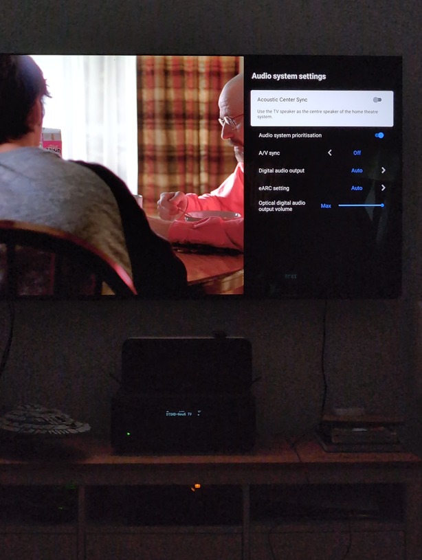

Hi, enhanced actually made it worse, it made normal DTS not work as well. I’ve put audio out on auto instead of passthrough on the TV, not Plex, seems to work so far.
AVR says it is DTS HD MA. It also sounds like it.
So I’m cautiously saying it’s solved. It’s such a weird thing. Auto should do the same as passthrough on this setting, as I’m getting DTS HD. So why the crackling when it’s on passthrough. Nuts :smiley:
