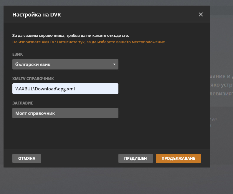

Thank you for the answer. I tried also this one several times but it seems Plex cannot find the file
Then I get this error

I have just tested a UNC Path for an xmltv file and it works ok
Check path and test the path directly
\\AXBUL\Download\epg.xml
and also check permissions to the plex user account
