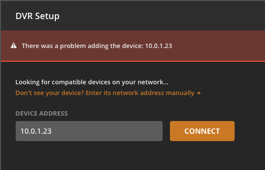

Anyone get the DVR setup on the Plex Cloud? I’m able to get it to work on my Mac, but when I add one on the Plex Cloud I just keep getting an error.
DVR and Plex Cloud won’t work very well together. If you know how to set up port forwarding on your router and a dynamic DNS entry you may be able to hack it together for network-based tuners, but remember you’re streaming the content from your home Internet to the Amazon cloud location pre-compression so the quality will be based on how good the Internet path is.
If you want DVR you’d be much better off setting up your own server, especially if you’re not using something like an HDHR Extend with hardware compression.
Thanks. Yes, I have my HDHR Extend working with a local Plex server. So it sounds like that’s the way I should stick with. I was just hoping to remove the dependency on my Mac always being up. Perhaps a Mac Mini dedicated for this purpose is in my future.
