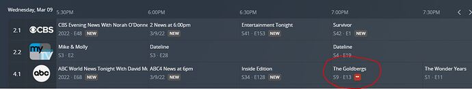

Not sure what to do… I set/rest many recordings multiple times and close to half just don’t record. They show they are going to record in the grid-guide but they don’t show in the DVR Schedule list. On the Recording Priority List many say ‘No Future Airings’.
I have tried setting them to This Episode/All Episodes New Airings Only/New and Repeat Airings. Doesn’t seem to matter.
I thought maybe it was guide trouble but again - it does show in the grid guide that the show is going to record so it must know it is there right?
Any hope of making this work?
Thanks.
Please provide a specific example and show screenshots of the basic recording configuration and the DVR Schedule tab where it should appear.
See screen shots below. This is just one example on one recording but there multiple others on different channels, days and times.
I’ve tried deleting and recreating multiple times. Seems somewhat random on if the show shows up on the DVR Scheduler.
Notice on this one the ‘Priority’ list shows the next Goldbergs isn’t until March 16th but the guide shows it on the 9th. Sometimes something that is on multiple times - like The Tonight Show - will say ‘No Future Airings’ and not record anything even when the guide shows it is set to record every night.

When Plex shows a red multiple dot record symbol on the Gride Guide, it only means that a series recording is associated with that show. Unfortunately it doesn’t mean that a particular episode is actually going to record - only the “DVR Schedule” tells you what specific episodes are going to record. It’s a Plex GUI quirky that often causes confusion.
