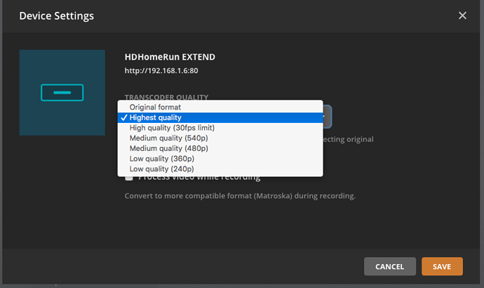

Check the Device Settings (the little gear icon) for the HDHR Extend in the DVR portion of the Settings for the Plex Media Server. I bought the Extend over the Connect because it’s capable of transcoding to h.264 before sending the stream to the Plex Media Server. Reduced the load on the PMS and saved disk space. As I remember, Original will send mpeg2. All other settings will transcode in the Extend before sending to the PMS.
Here’s a screenshot of the Plex Media Server 1.6.1 Device Settings I have:

@ChrisAWallace “As I remember, Original will send mpeg2. All other settings will transcode in the Extend before sending to the PMS.”
That is great information; where did you get it? I, along with many others, have been confused about how to make sure the HDHR Extend is doing the transcoding, rather than the PMS.
@geoland1st Silicon Dust explains some of the settings on their end in their HDHomeRun HTTP Development Guide at the bottom of page 2 under Transcode Profiles: http://www.silicondust.com/hdhomerun/hdhomerun_http_development.pdf. Basically any setting other than Original transcodes the incoming stream to h264 before sending it to Plex.
