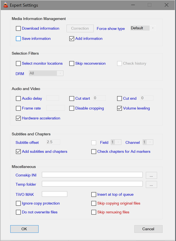

I have a feeling I may have mixed up some of my NextPVR config with my Plex config, but here are the current settings:
Almost identical settings. About the only difference I see is that I use some custom file renaming to actually move the file into the appropriate library when mcebuddy completes. This causes Plex to add a line in the log that says something like “Post Processing Deleted The File - Silly Script” and Plex removes the entry from the recording schedule so I don’t see the item with the play button beside it.
Ok, good deal… I’ll report back after the next recording. :smile:
