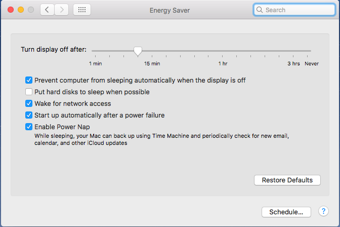

I may have another piece of the puzzle solved, or at least something to try that may help. I was noticing that it always seemed like shows would fail after I had been away and not accessing the the Mac Mini for a while. So I changed the sleep settings to never let the hard drive spin down and so far I have had one show complete after not touching the machine in any way for 2 hours. This is strange to me since before all recordings were recording the full time, but I will watch it for 24 hours and report back if this fixes it for me. Also, with the latest silicondust firmware we seem to have solved the corruption problem at least.

Well, I think adding the change to my energy saver settings on the Mac mini was the key. All recordings have worked since then, and all are complete and non corrupt! I am probably tempting fate with this, but here are the next things I am going to try to see if it continues to hold:
  1. I will schedule via the web app (previously I had been sticking to the ios app for that as suggested)
  2. If that works, I will try turning transcoding back on in the DVR device settings
IF those two things above both work for me (a big if I know), it would seem that this whole problem has been fixed by the combo of hdhr firmware 20170612beta1, PMS 1.7.3.3937, and tweaked sleep settings for the mini. I will report back in a few hours…

I feel like I found the holy grail. I have now successfully recorded full length, non corrupt shows using the following:
  1. Mac mini running PMS 1.7.3.3937 (Mac OS Sierra 10.2.5 and with energy saver settings see image below)
  2. HDHomeRun Connect with firmware version 20170612beta1
  3. Both the mini and the hdhr are connected to the same router via ethernet (an RT-AC68U)
  4. Transcoding is turned ON in DVR device settings (but works fine if OFF too)
  5. I can schedule shows via IOS app or via web interface, both work fine
Hope the above helps others, I am happy to finally have this working as expected.
