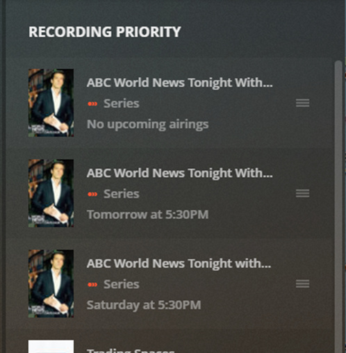

This is what the Recording Priority looks like after the show changes to No upcoming airings and I add the show back to the schedule. The same show that is scheduled to record on Saturdays continues to record every Saturday so far.

I have stopped removing the Series scheduled recording that shows “No upcoming airings” and this seems to have taken care of the problem for me.
To restate, as long as I leave the 3 scheduled series recordings (1. No upcoming airings, 2. Tomorrow at 5:30 pm and 3. Saturday at 5:30 pm) as pictured in my previous posts, the show records all of the time.

I can see that the EPG data we receive has two different series identifiers but both have the same series title
“ABC World News Tonight With David Muir”
One is for Mondays to Saturdays and one is for Sundays.
I will refer this to our provider
May be all it needs is that you create two separate schedules - one for the Sunday airings and one for the Mon-Sat airings
We did stop matching with theTVDB earlier this year - so if you do not have previously tvdb matched shows in the library and have a DVR recordings separate library (one for shows one for movies) then I expect the EPG metadata to be preserved and would remain as two separate series - one for sundays and one for monday to saturday
OK i can see the issue now. Sorry. I am going to edit my earlier response and will refer it to our provider
There are two series but they both have the same title !
I am referring this to our provider.
I have referred it to our provider requesting the different series have different titles
There are actually 3 different series, one for Monday-Friday, one for Saturdays and one for Sundays. The alternative option is for them to be combined
