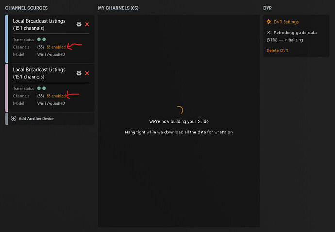

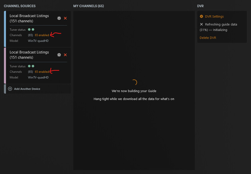

I’ve completed deleted my DVR… then re-add my two tuners. They work for a bit, but then stop working after a little bit of time (30 min to 1 hour maybe). If a stream is playing already it will keep playing, but cannot start any new streams (even though I have 4 tuners)… and the guide is gone.
Both tuners change from 65 channels to 19 channels (which don’t actually exist).

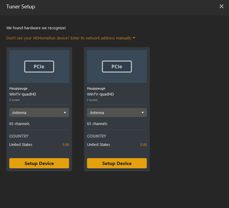

I just lost my tuners again, but this time it’s a bit different. Instead of having to delete the DVR when I went into Plex setup the DVR is already gone on its own. It also says “We couldn’t find any hardware we recognize, but will continue to look for available devices.”, but WinTV is working perfectly so I know the hardware is still functioning properly.
After stopping Plex Server and restarting it the DVR was there in setup, but the DVR/tuners were non-functional until being deleted and readded again.
