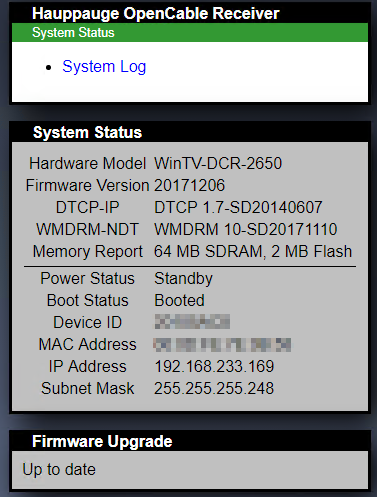

The cable card tuner creates a network device in windows. supply plex the IP address of the network interface it will auto detect as a hd homerun. please see the attached screenshot for more info.

On your Plex server Go to Control Panel > Network and Internet > Network Connections. find the network connection labeled “WinTV-DCR-2650 (Model 143xxx)” and from the right click menu select Status then Details now look for “IPv4 DHCP Server” enter the listed IP address in to a web browser then click the link for “System Status” now Call Comcast and provide the agent with the Device ID and MAC Address, when the agent asks if your installing the cable card in a TiVo just say yes and move on its best to not confuse them with what you are really doing.
