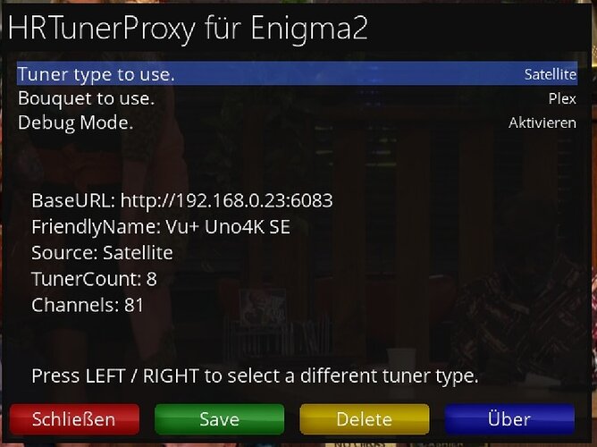

plugin looks good all fine
2018-06-28 12:01:52,145 INFO BaseURL: http://192.168.0.23:6083
2018-06-28 12:01:52,145 INFO FriendlyName: Vu+ Uno4K SE
2018-06-28 12:01:52,145 INFO Source: Satellite
2018-06-28 12:01:52,145 INFO TunerCount: 8
2018-06-28 12:01:52,146 INFO Channels: 1605
2018-06-28 12:01:52,146 INFO Bouquet userbouquet.dbe0d.tv
so now need log from plex, but it looks to be an issue with plex not the plugin, one thing though try to reduce the number of channels, plex does no like that many channels, it borks when more than few hundred.
I have only 1 boupuet and there are 81 channels in. I donÂŽt know why the log says there are 1605 channels in. In the plugin settings it displays correct.
Plex displays the 81 channels also correct.
