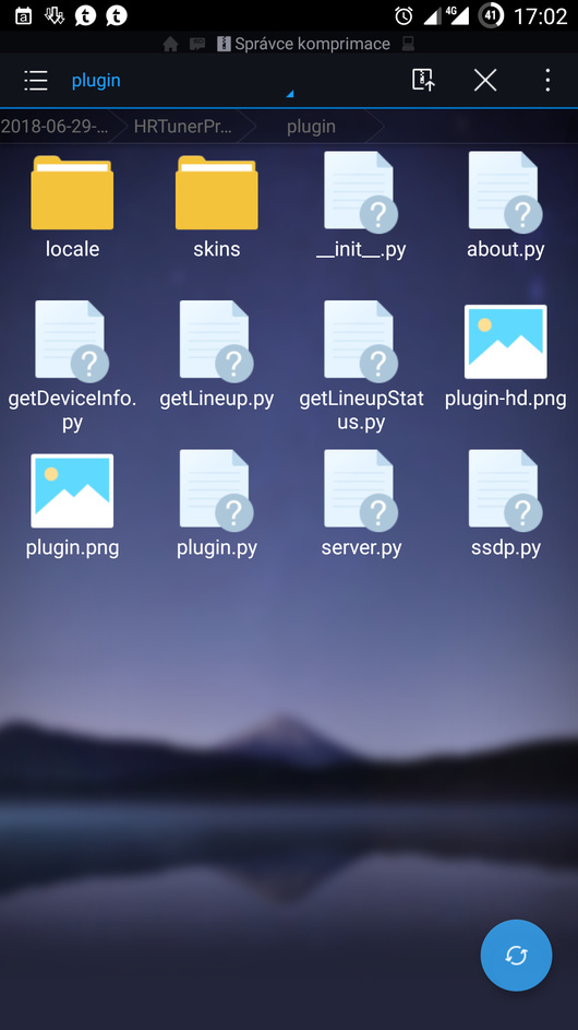

I have downloaded the HRTunerProxy-4.0.zip file from gitHub, put it on /usr/lib/enigma2/python/Plugins/SystemPlugins/ and unzipped in HRTunerProxy/. I have also restarted the decoder.
Where should I find the plugin now? Thanks, I will eventually get it there…

Did you copy content of folder ‘plugin’ like I sad?
If so plugin is normally between others plugins. Yellow or green button on remote control?
Ouch I did forgot to rename the folder without the package version :slight_smile:
But I still don’t know where to find it…
Are you absolutely sure that you have files in the right place? __init__.py and others files have to be in HRTunerProxy.
What is your sat box? Mips or arm? I have VU+ Ultimo (mips) and have to enable enigma loging to know what is wrong during plugin loading. I have to upload few py files.
Arm don’t know.
