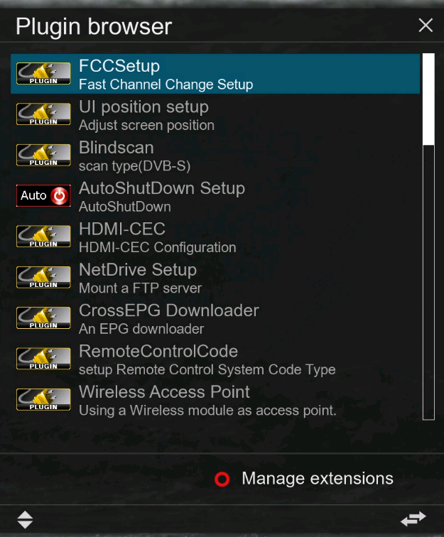

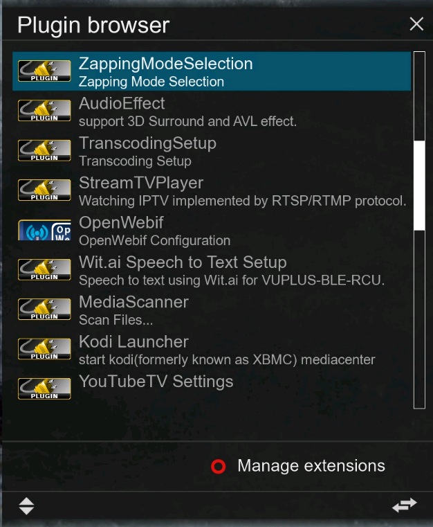

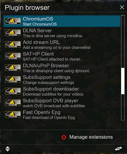

Indeed, as you can see from the escreenshots below, the plugin is not there:
Unless someone confirm otherwise, it seems therefore that HRTunerProxy does not work on Vu+ decoder with MIPS processor architecture and Black Hole as OS.

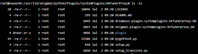

I just realize that you actually just used the sub-folder “plugin” of the package. Here is my content:
6
So I have done the following and restarted the decoder again (init 6):
7a

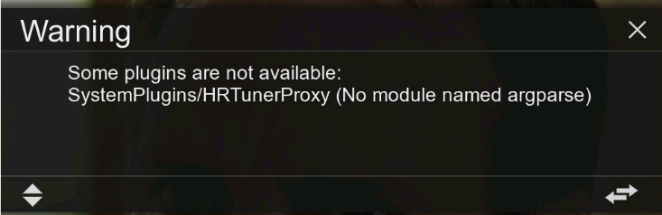

But then I receive the following error:
From a quick search it seems that I should install a python library (libpython3.4-minimal). Is that correct?
I tried to do so with opkg, but it seems that such library is missing:
8
Any idea? Thanks a lot!
Sorry, I made it (it seems)!
Lurking further on the net (here) I have been redirected to the right path:
After a new restart (init 6), I can finally see the plugin appearing:
10
Now, I just need to configure it :slight_smile:
11
For the benefit of other BH users, here is the full command:
root@192.168.1.47# cd /usr/lib/enigma2/python/Plugins/SystemPlugins && wget https://github.com/OpenViX/HRTunerProxy/archive/4.0.zip && unzip 4.0.zip && mv HRTunerProxy-4.0/plugin HRTunerProxy && chmod 755 HRTunerProxy && rm 4.0.zip && opkg update && opkg && opkg install python-argparse && init 6
