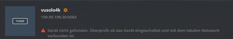

I found that in the log…it seems the grabber use the wrong Port :6083 but i have added the receiver as multi :6084
could that be the reason?
Edit: Sep 01, 2018 21:39:06.622 [2880] DEBUG - HTTP requesting GET http://199.99.199.30:6083/discover.json - again Port 6083
Edit2: http://199.99.199.30:6084/discover.json works in my browser as the plugin is listening to :6084.

Is it normal that Plex is trying to connect to all Ports?
HTTP error requesting GET http://199.99.199.30:6081/discover.json (0, No error) (Failed connect to 199.99.199.30:6081; No error)
HTTP error requesting GET http://199.99.199.30:6083/discover.json
HTTP error requesting GET http://199.99.199.30:6084/discover.json
Crazy because i can setup all channels once and then this is happening.
Could it be that there is in Plex an old setting from my receiver with different image before?
Sep 01, 2018 21:41:05.728 [0988] DEBUG - DVR:Device: Testing grabber HDHomerun device device://tv.plex.grabbers.hdhomerun/4XEPX0MO at http://199.99.199.30:6083
Sep 01, 2018 21:41:05.728 [0988] DEBUG - DVR:Device: Testing grabber HDHomerun device device://tv.plex.grabbers.hdhomerun/KQMS2M29 at http://199.99.199.30:6084
Sep 01, 2018 21:41:05.728 [0988] DEBUG - DVR:Device: Testing grabber HDHomerun device device://tv.plex.grabbers.hdhomerun/WAMSO7J1 at http://199.99.199.30:6084
Sep 01, 2018 21:41:05.728 [0988] DEBUG - DVR:Device: Testing grabber HDHomerun device device://tv.plex.grabbers.hdhomerun/WTBFVAAR at http://199.99.199.30:6081
Sep 01, 2018 21:41:05.728 [0988] DEBUG - DVR:Device: Testing grabber HDHomerun device device://tv.plex.grabbers.hdhomerun/X40VGCW0 at http://199.99.199.30:6084
Sep 01, 2018 21:41:05.728 [0988] DEBUG - DVR:Device: Device device://tv.plex.grabbers.hdhomerun/4XEPX0MO died
Sep 01, 2018 21:41:05.744 [0988] DEBUG - DVR:Device: Device device://tv.plex.grabbers.hdhomerun/KQMS2M29 died
Sep 01, 2018 21:41:05.744 [0988] DEBUG - DVR:Device: Device device://tv.plex.grabbers.hdhomerun/WAMSO7J1 died
Sep 01, 2018 21:41:05.744 [0988] DEBUG - DVR:Device: Device device://tv.plex.grabbers.hdhomerun/WTBFVAAR died
Sep 01, 2018 21:41:05.760 [0988] DEBUG - DVR:Device: Device device://tv.plex.grabbers.hdhomerun/X40VGCW0 died
Why are there 3 different devices for Port 6084? Maybe old device ID? Can i clear that?
Is anyone else having this issue with the Plugin? Is Plex still seeing your device?
Nobody with the same issue? Is the vusolo4k working for everbody? No device not found error?
I appreciate every help. This is so annoying if i need to change something.
Streaming and recording works but i cant change or add channels because of the error.

Ah damn…i really need help about that. Now i tried to delete and add again but now i am also unable to add the receiver again. Are the devices not registered somewhere and maybe still the cache left and is causing this issue now?
I want to use OpenPLI 6.2 as an image would be nice if somebody know more about…
As i did delete the receiver in Plex now…i tried to delete also the cache but when i start Plex i can still see ip from receiver and HTTP requests…

How can i delete them completely from PMS?
Sure, get a player device that can natively display mpegts :wink:
Jokes aside, which clients do you use?
PS4 and mostly android or Web Player, but the clients are not the problem. If i setup before it worked for all my clients. Last time i want to add a channel and could not due to error. So i deleted the receiver and added again with the additional channel.
But now i cant add the vusolo4k anymore…No DVR connected and i still see this in the log. Maybe it would help when i delete those entries, but i dont know where…i cant find the location
