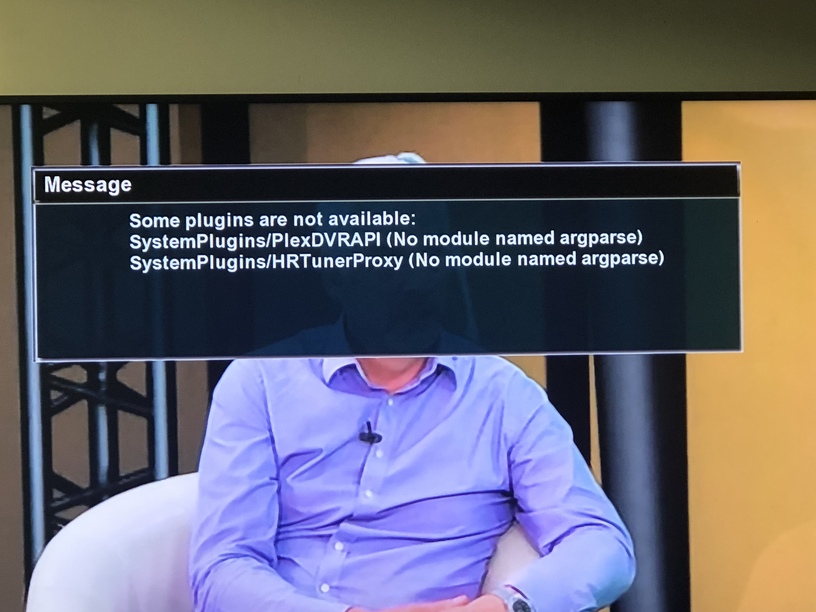

I need help I got dm 500hd Enigma2 I cloudnt find hrtunerproxy or PlexDVRAPI in plugin feed download. After reading everyone else instructions I placed Hrtunerproxy and PlexDVRAPI in system plugins by following the instructions. But I am stuck on same error on both plugins new Hrtunerproxy and older version PlexDVRAPI. ‘No module named ArgParse’. Kindly guide me how can I resolve this error.

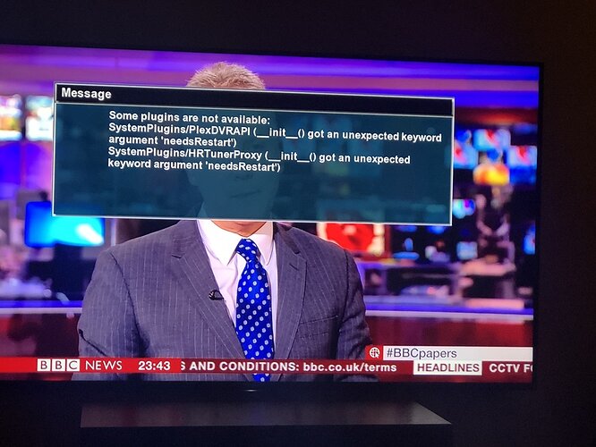

I progress one step forward by placing argparse.py in enigma main python files. But now I am stuck on new error even I restarted box serval time but still not going away. Kindly help please
Error (init() get an unexpected keyword argument ‘NeedsRestart’.
Where and how exactly did you place the folder of HRTunerProxy?
I placed all files from HRTunerProxy/plugin to my dreambox DM 500hd /usr/lib//enigma2/python/Plugins/SystemPlugins/HRTunerProxy
And I applied same file permission on this folder as other system plugins have.
Earlier I had argpaarse error which I resolved it and now I am stuck on this above one.
Please guide me if I missed anything.
I think you have to install argparse with opgk install. Not just by placing the py file on the receiver…i think there is still something missing. You have to search the thread, because somebody already had the same issue! Enigma2 support for Plex DVR/LiveTV!
opkg install python-argparse…but read the Post in the above link which i posted
Thanks buddy but opkg install python-argparse is not working for me.
Even as what guy tried, I try to install python-argparse ipk but i get this error
Capture
Kindly guide me if i can try something else
Try to make first:
opkg update
opkg upgrade
and then this should give you the name of the package:
opkg list |grep argparse

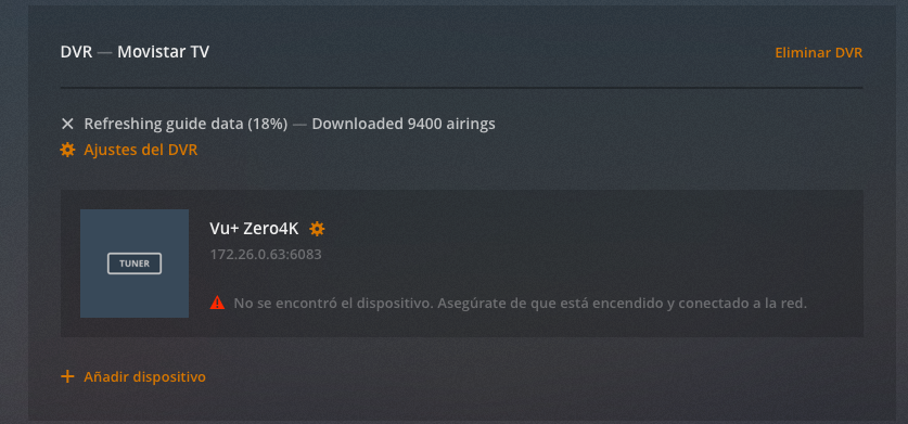

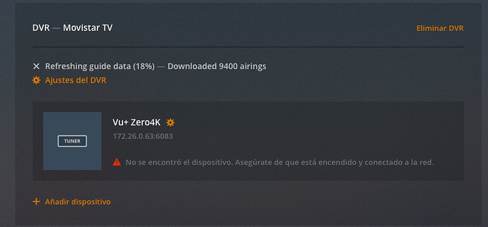

I have installed the plugin in my VU+ Zero 4K running latest BlackHole image.
Everything went smooth and I have all the channels, EPG and everything listed in Plex. But I can’t play anything.
I get this error:
Playback Error
Unable to tune channel
04
I’ve been looking around for this message but I don’t see anything clear. Do I have to do some configuration elsewhere?
I’m having some kind of issue because now it appears as not connected
But if I load the IP address on chrome it shows a XML file.
Where is the problem here?
