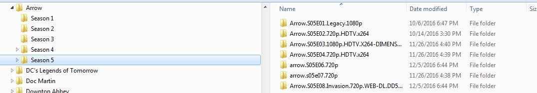

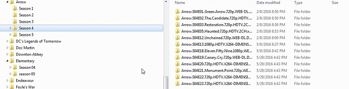

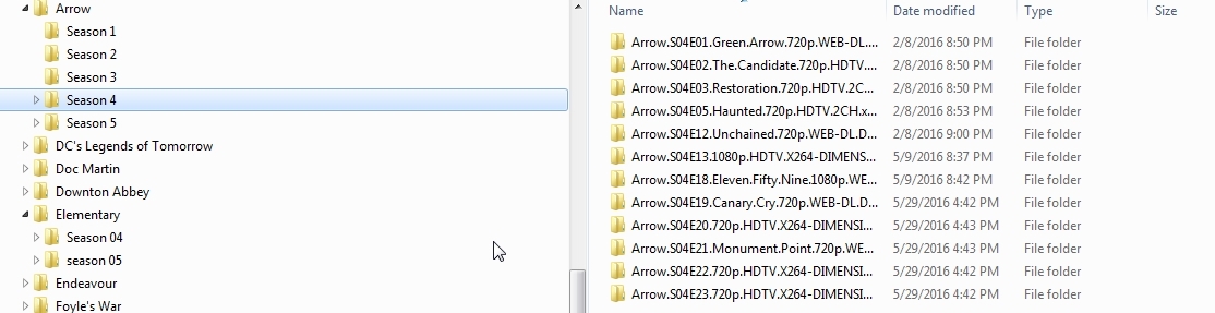

Arrow season 4 is named this way and DOES show up

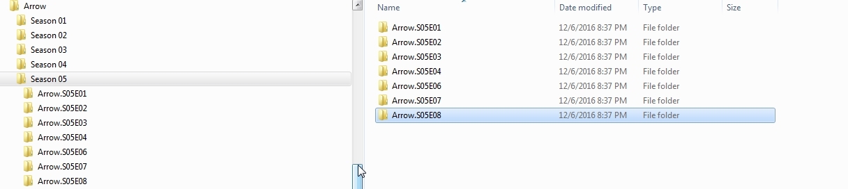

Arrow season 5 is named like this and does NOT show up
The first 4 seasons are in the catalog but not season 5. Naming looks the same to me. What am I missing?

well I ran filebot. Normalized the naming of this show and it still only shows 4 seasons. Nothing in season 5 shows up in the database so nothing in season 5 can be streamed.
