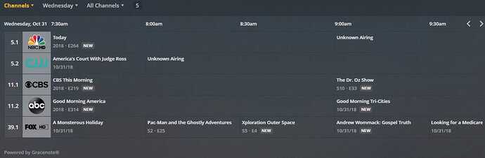

EDIT: I have attached a screenshot of the current Guide view. It’s even worse now - listings for channels 5.1 and 5.2 stop at 8pm whilst the remaining three OTA channels have two full weeks of listings.
EDIT 2: As primetime approaches, the guide for 5.1 and 5.2 has now updated to show info up to 8am tomorrow morning instead of 8pm tonight. Which is good since it is not missing the recordings of any primetime shows. However, I don’t understand how it is updating, but only enough to get the next few hours of guide data for two channels, but two weeks’ worth for the other three.

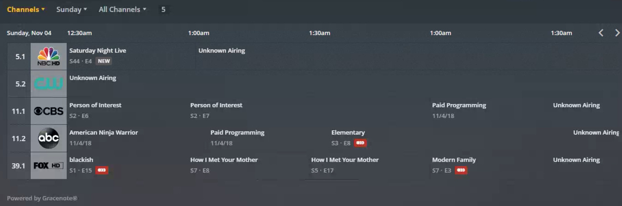

I don’t know if it’s relevant/related, but I also just noticed something weird that happens even on the channels that don’t have the problem. As I scroll to the future in the guide, I notice that the future-most program shows as Unknown Airing if its finish time is beyond the end of the displayed guide. When I scroll a little further it magically changes to the correct listing and the next program shows as Unknown Airing. You can see what I mean for channels 11.1, 11.2, and 39.1 in the screenshot below.

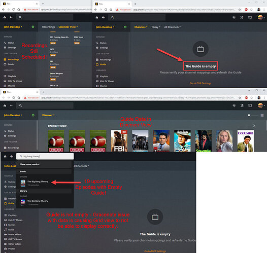

Try switching to the discover view of the guide instead of the Grid. The problem is with data in the EPG that is not allowing the Grid to display properly as I understand. Here is a single screenshot showing my upcoming recordings are still scheduled, my Grid says empty, the Discover view of the Grid shows data, and if I search from the Grid view it shows 19 upcoming episodes in the Guide for The Big Bang Theory. If I look out in the future for recordings I see scheduled recordings out until 11/24, today is the 10th so 14 days of guide data.
