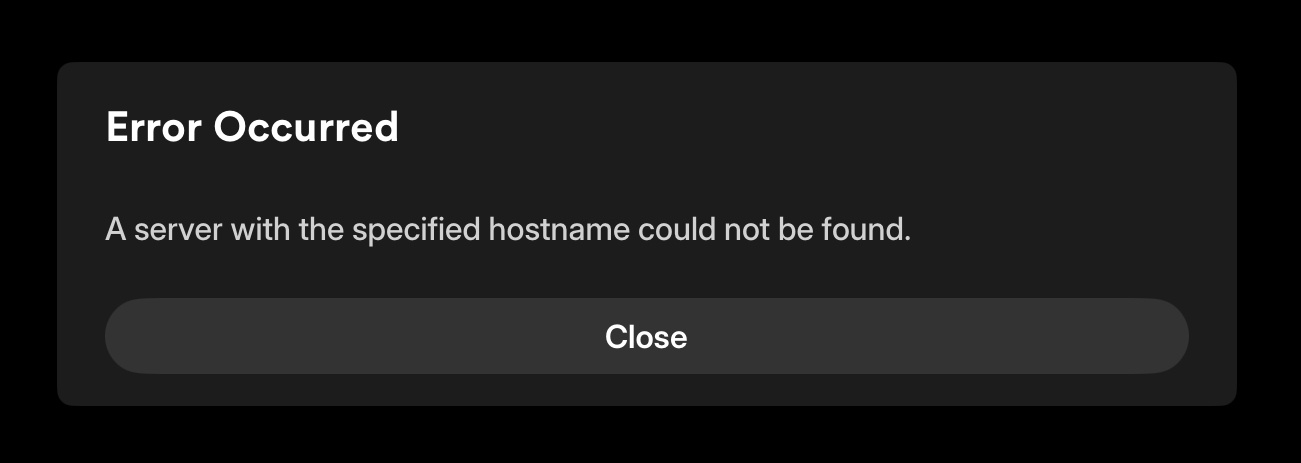

The error message is as unhelpful as @johnlamox expressed it to be. I’ve attached a screenshot.
I run my own Unbound server for DNS. Looking through the logs, I can see the client is requesting 192-168-[redacted].[redacted].plex.direct, for which my server returns NODATA.
Changing my DNS to 1.1.1.1, this resolves the issue and I’m able to stream again. Looks like my Unbound config needed the following added to the configuration:
server:
    private-domain: "plex.direct"
I’m now able to use my private DNS and stream.
