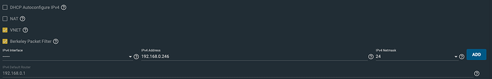

In your Plex jail configuration, don’t specify an IPv4 interface (just leave it default):
I normally use DHCP but I just tested with a static assignment. If I specify an interface (vnet0:bridge0) the jail fails to start with the VNET error. If I leave it blank/default, the jail starts and functions normally.
this is exactly what is happening with me
but i need a fix , this is not logic
this didn’t made the option in order to have it not working
i really do not understand why is this happening
Perhaps I wasn’t clear: This will work, with VNET, if you leave the IPv4 Interface field blank. It only fails if you select the “vnet0:bridge0” option from its drop-down list. That screenshot I posted above was from a working Plex jail using VNET networking. So you can use VNET, it will just use the default interface (vnet0). This would be the same as running for example the following from the command line to configure the jail:
iocage set vnet=on Plex
iocage set defaultrouter=192.168.0.1 Plex
iocage set ip4_addr="vnet0|192.168.0.250/24" Plex
Assuming you’re on a 192.168.x.x network and your jail is named “Plex,” the above would configure it to use VNET networking.
And for what it’s worth, this behavior isn’t specific to the Plex plugin-created jail; the VNET error occurs if you create a generic FreeBSD jail as well. Whatever the underlying cause of this behavior is, it has nothing to do with Plex.
