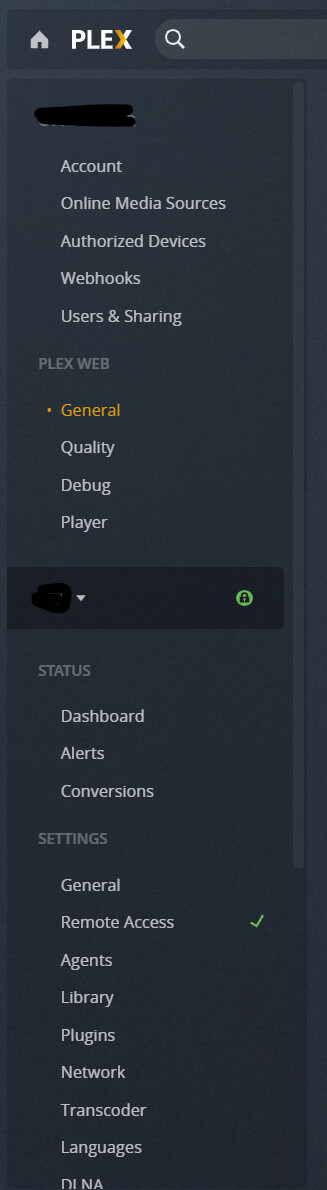

Thanks for the info however I cannot find the path you mention in the settings menu.
Screenshot 2021-07-06 at 11.17.12
Your screenshot is showing the Server settings area.
You need to enter the settings of Plexamp

Which type of Plex app are you using for playback?
I seem to be getting utterly confused!. I did initially download Plex for Mac but for some reason added all my folders using the server. Downloaded the app again but when I open the app it says server not available, presumably need to sign into the server, but when I did still do not see those particular settings?. Think I need to go back to basics and must be an age thing!.
The settings you showed above are existent in both the web app and Plex for Mac.
Immediately above them are the settings for the client.

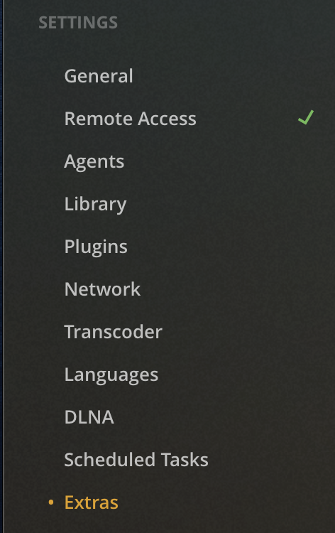

Here are they in the web app:
grafik

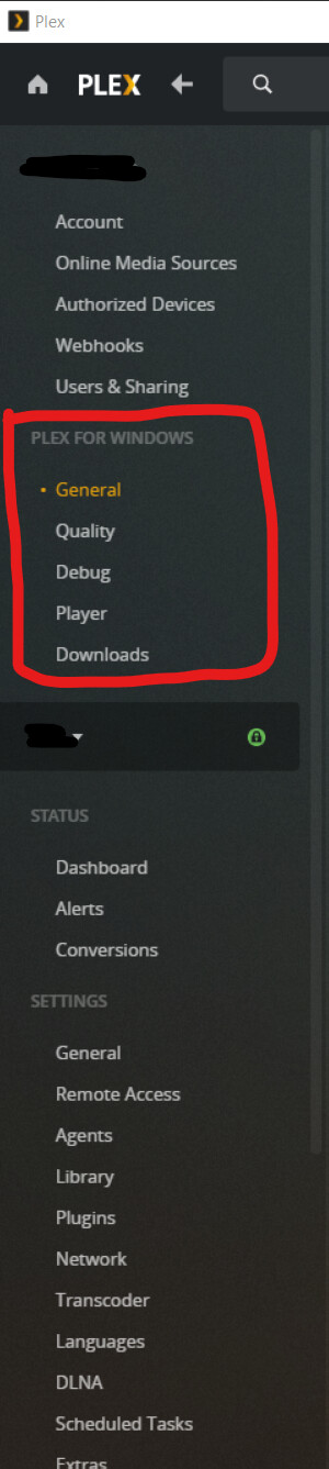

Here is are they in Plex for Windows
(which should look identical in Plex for Mac, apart from the name)
grafik
