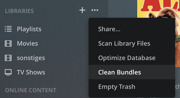

If you rename the files it appears you do need to go through the Plex Dance sequence
See http://forums.plex.tv/discussion/277433/the-plex-dance
OK. I will try that. What is meant with “clean up bundles”?
Found it…!
OK did that. However, now all subtitles are gone. They’re still in the folder, but Plex shows “none”, when I look it up on Plex.
