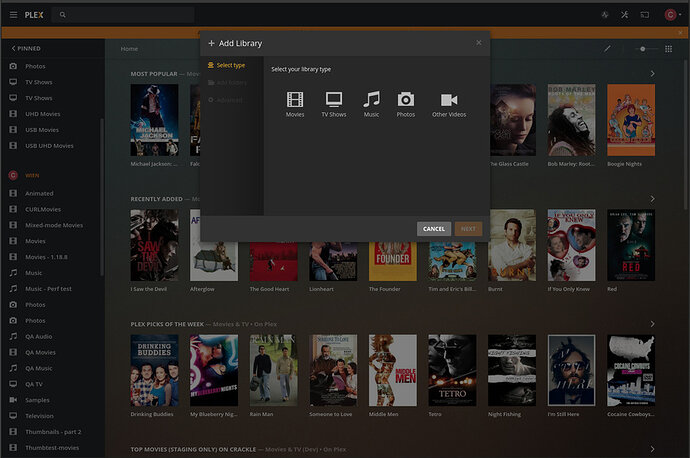

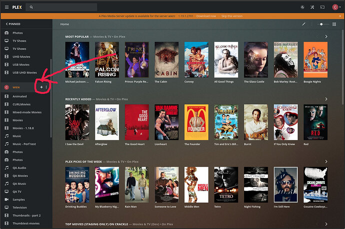

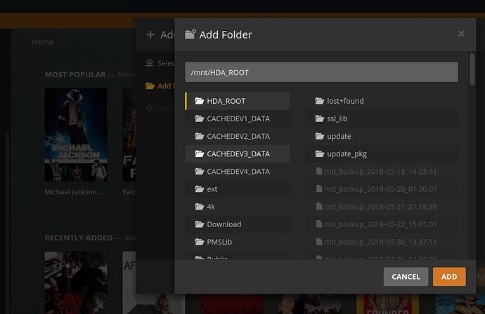

Get to the server (left panel) and click the +
Once you define the type, Browse to add directories. You may need to navigate up to the root or just start typing the pathname .

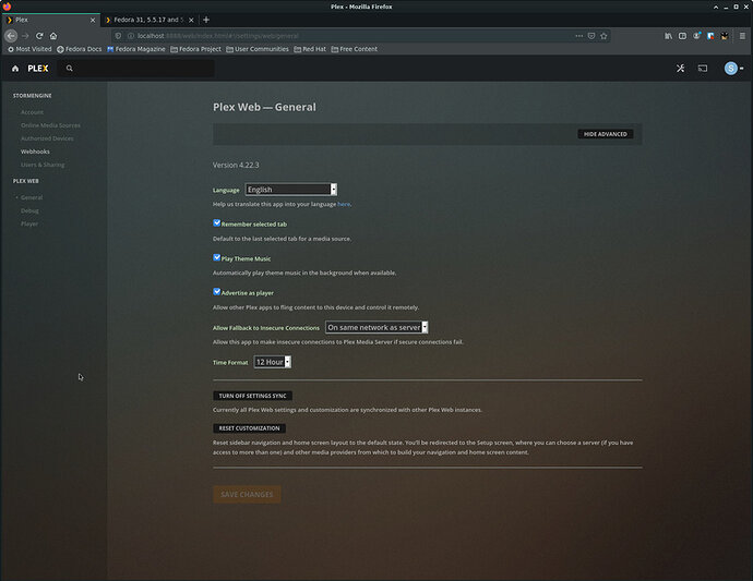

This is one is right from the server

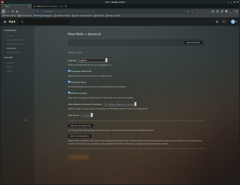

Sorry, I should have been more specific. What does the settings page look like?
This?
Yes, that. Try signing out at the top-right and close that browser window. Open a new private browser window and access the server again through the tunnel. See if it allows you to claim the server and log in.
