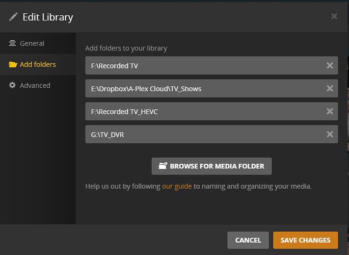

Have you considered using one library? You can have multiple folders added to one library. Like I mentioned in a previous post my recordings are done using G:\TV_DVR, think I said just G:\DVR. I then post process using mcebuddy and recordings are placed in F:\Recorded TV. I also have 2 other folders configured for my TV Shows library as shown in image. This has the advantage of episodes that I already have in my TV Shows library are not recorded multiple times, unless I have the replace with higher resolution option enabled.

Yes I am able to add without having to Plex Dance. Just looked at my mcebuddy logs and see 108 recordings over the past 7 days were recorded on one drive in library, processed by mcebuddy, and moved to other folder in library. Plex sees all of the files and can play any of them.
Update: Removing the two libraries and combining the recording folder and processed folder into one library has done the trick. It all works as expected now.
