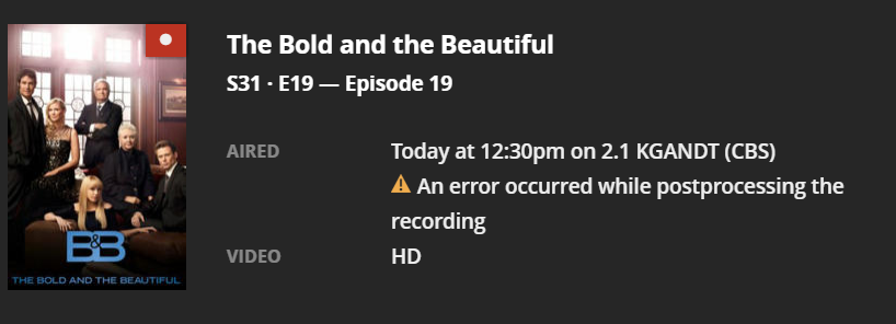

I think that I almost have it! The recording for her soaps ran and I setup the filter so that it doesn’t process it but it is showing that the postprocessing had an error. Is that because it passed though or can I expect the rest to have issues too?

If the recording was not processed by mcebuddy it should not have a post processing error. Can you post your mcebuddy.conf file and if there is a log file for the show in mcebuddy?
If you can also PM me the post processing script you are using. The script should have called mcebuddy, then if you are ignoring the Soap mcebuddy should have ended and then the script would have ended and released the recording to Plex to move into the library.

I think that I almost have it! The recording for her soaps ran and I setup the filter so that it doesn’t process it but it is showing that the postprocessing had an error. Is that because it passed though or can I expect the rest to have issues too?I have some recordings tonight. I guess I will see what happens.
You excluded it but did you create a process that included it? If not it just died in MCEbuddy bc the re was nothing to be done to it.
Do I have to edit the postprocessing script in any way? I left it as default. There isn’t a log file for the show. I removed the filter after the shows failed earlier and it is still give the PP error.

Here is my config file. I think the error is with the postprocessing script. I didn’t edit and thinking from they way your are talking, it may need edited. MCE buddy is install using the default setup
